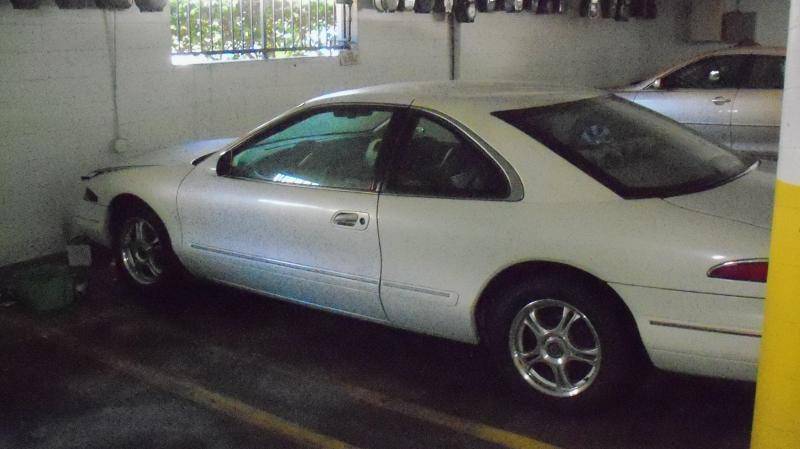

So my sister was driving my car when the message popped up to "Check engine temp". Of course it was on high but she kept driving it because another message came which said "Engine error" apparently which I guess to some people means keep driving. Also she says the temp gauge totally went to "C". She drove the car for 9 miles like that when she took an exit toward our house and the car completely stalled/seized. so I come over and a road ranger is there behind her and apparently jump started the car. I run over as she is pulling out into the traffic and is waiting on a light. The cars temp gauge is pegged to "H", low oil pressure light is on and the car is making a grinding/knocking sound. Can't pull over any where since she is back on the road, no shoulder and the light is red. After the light turns green, we find the closest place to pull over and shut her down.
Tow it back to my house, and let it cool down. At this time I am thinking it is the oil pump that went bad. But I started it after it had cooled down but there is no low oil pressure light. Seems to run fine except the the knocking noise. haven't run it to see if it overheats. Now I am thinking it was a maybe a stuck thermostat or something blocking the oil pumps neck.
Going to go take a short video but looks like the engine is shot now. It sucks because if it would have been cooled down, it would still be running probably.

I don't think it would be wise for me to put another engine in it. It has chipping paint on the driver side door and front fender. For it to be a nice car, it would need a new engine now and a new paint job. You can find decent Mark VIIIs for $4000 - $7000. Don't know if it will be a Mark VIII even . Still have three Mark VIIIs, so not gonna be without them. we need a four door or an SUV maybe.
