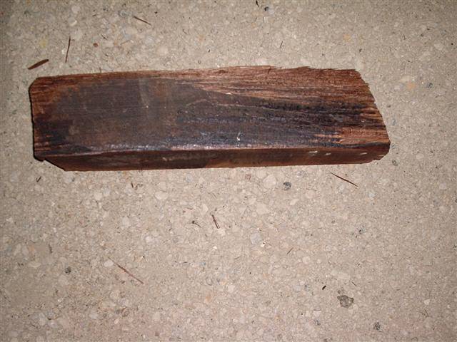

No here is the worst part I get to El Paso ill and I was doing about 70 when I get in the left lane to get past a truck and there is this 6x6x24 bored in the road. I dint have time to react, I hit it with my drivers front the hole car goes a foot in the air and the engine stalls,

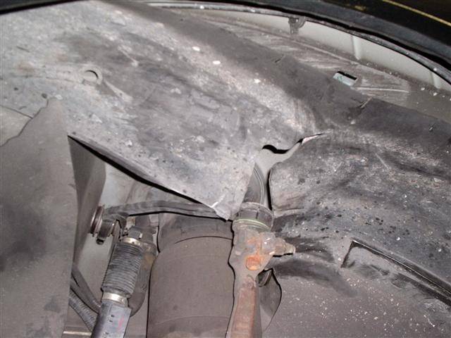

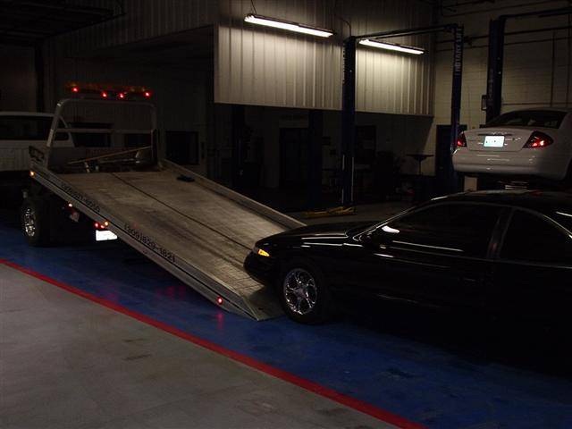

I manage to regain control of the car and bring it to a stop. After dealing with the state trooper the flat bed shows up and we head back to a ford dealership. (Keep in mind this 10:00pm last night). So he drops the car off in the service bay. We get it over to a lift and look at the damage, the strut tower has a hole in it from the control arm going through it, part of the sub frame is damaged and the hydraulic for the hood was bent and broken.
We removed the inner fender (course that was deserted) and get the spare on there then we try to figure out why the car wouldn’t start, than I realized the inertia switch, flipped it and the car started right up. Got out of there for 70 bucks.

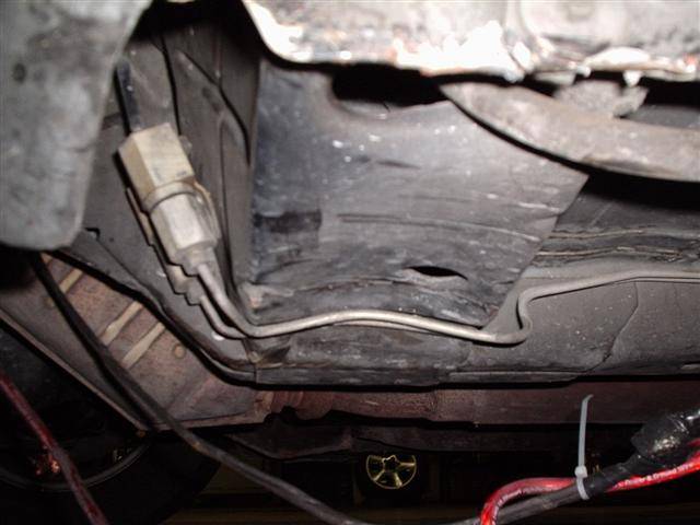

I had to drive 450 miles on that donut, so now the car sits in my driveway on jack stands taken apart. It looks like some fuel lines got smashed so I need to replace them with steal breaded lines and the fuel pump as long as the tank is down,
