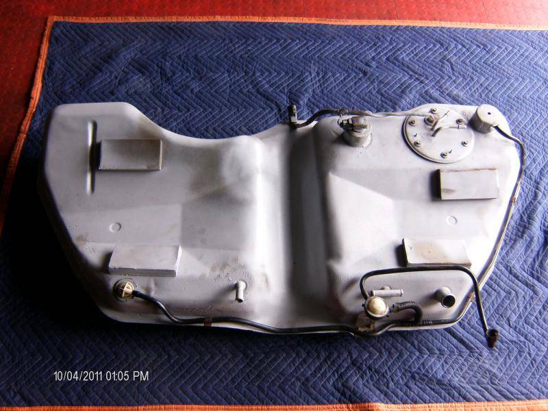

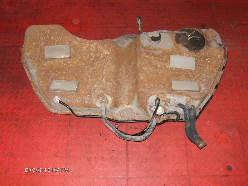

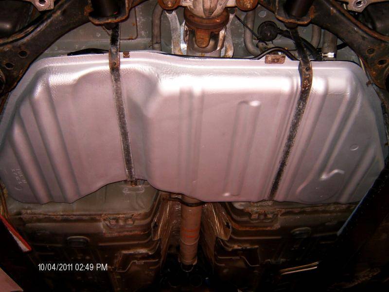

They absolutely do, I've done it. :rolleyes:
The only difference is in the emissions hoses, the bare tank itself is exactly the same. ;)
The first pic is a '98 tank. The second is a '97 tank (after I swapped over the emission lines). The third pic is the '97 tank installed in a '98 LSC.

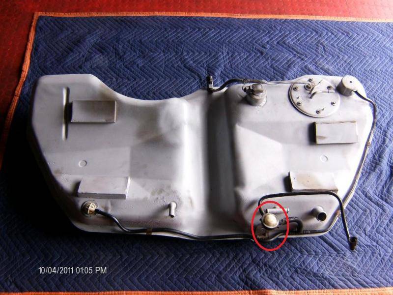

The pics above are the '98 lines. I don't have pics of the '97 lines.
I do know that the junction (circled in red) is different between the years and there is another hose on the '97 setup.
