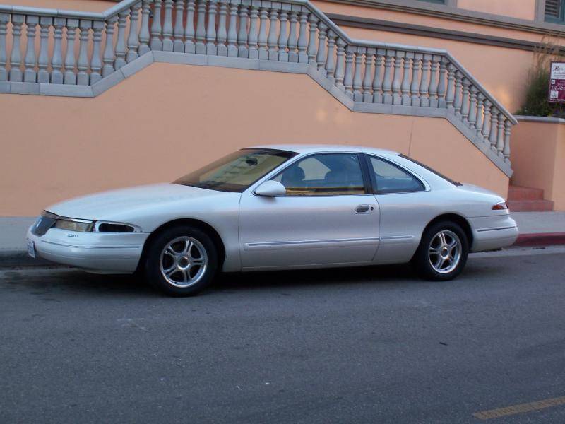

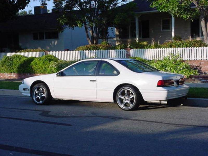

The car did not sit normal after that, so I had to use zip ties to lock it in place. At $15.00 per stud I find it almost offensive that Ford is doing that ****.. Next time I break one, off to the hardware store I go and when I find the right one Ill buy a LOT of them! I did manage to snag a pair from the wrecking yard off a Mark that just should not have been there - recent strut masters conversion in the rear with fresh eibach springs and fresh bags, ball joints etc.. on the front. ALL of it was gone when I came back 2 days later to get those, and the headlights/parking lights were gone as well; I had a feeling that would happen. The radiator neck broke off (like mine and many other marks), and I assume this guy overheated and damaged his mark (at only 106k), and the guy probably got overwhelmed after having to dump so much $$ to fix his suspension, and then that radiator broke.. I took as many good parts off it as I could, and it made my Mark a happy camper, the more and more I put on. I still have a pile of parts to install on my Mark, and will keep going until it looks like my Tbird did. Thunderchicken.jpg
Holy fender gap!! :rolleyes:
