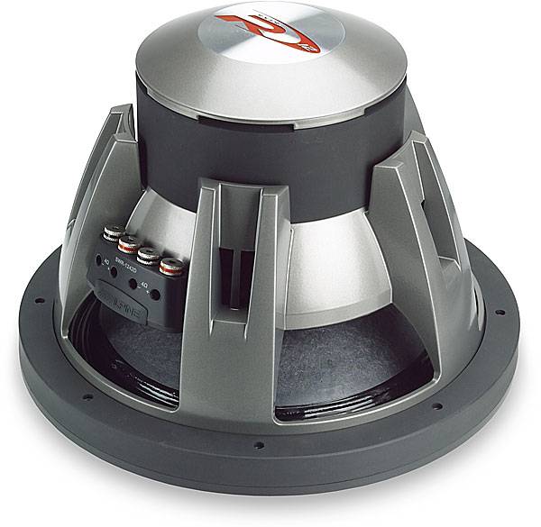

I just got one 12" Alpine Type R SWR-1242D (dual voice coil) (4ohm), but I am very confused on my wiring options since I've never gotten a dvc sub before. I did some research but still I find my self lost.. here are my amps capabilities:
200 Watts x 2 @ 4-Ohms
320 Watts x 2 @ 2-Ohms
500 Watts x 1 @ 4-Ohms
Can someone please help me wire my sub. Thanks.
what kinda amp do you have you might just want to run one side of the voice coil to each side of the sub but what kinda amp is it
Its a swiss audio (son of audiobahn) smx 2400...you guys probably never heard of them since theyre new...... but I was amazed at their sema booth demonstrations, this amp is very tiny and weighs almost nothing but pounds hard. I used it bridged with my old single voice coil sub. So, by wiring the sub to a 2ohm load will I only need to use one channel?
Heres what my new sub looks like:

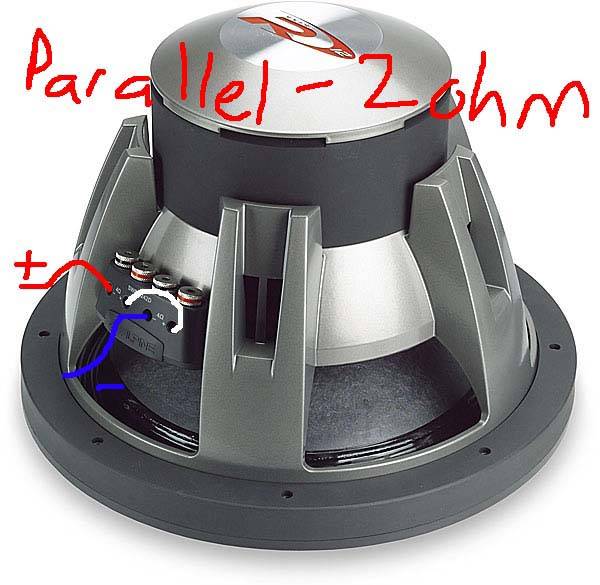

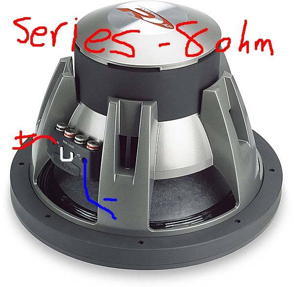

Thats a really bad sub amp combination. You seriously can probably blow the amp by trying to push it @2 ohm bridged. And Wiring it in series would be underpowering the sub.
Underpowering a sub does not hurt it though.
2 chices, wire the sub in parallel and it will meet RMS ratings and should get pretty loud. (if the amp can handle it) the second your amp starts to get hot or blow a fuse or cut out turn it off and wire the sub in series.
Or wire it in series off the bat, it will be safe for both the sub and amp as long as your gains are set properly and not clipping the signal to compinsate for the low output of the sub.
