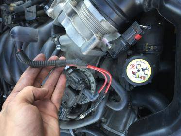

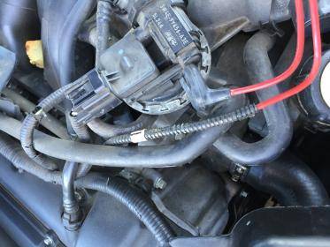

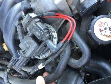

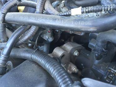

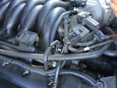

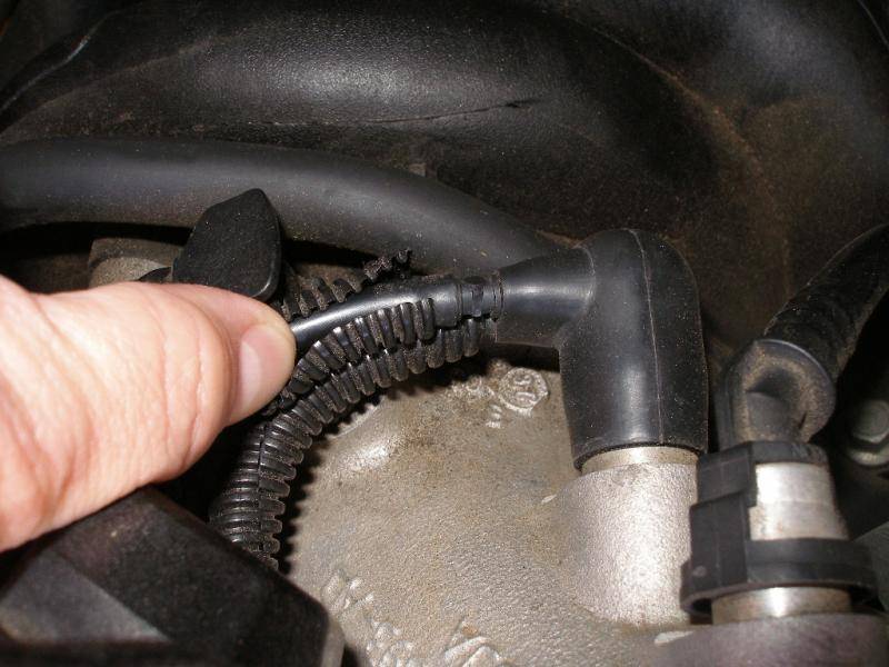

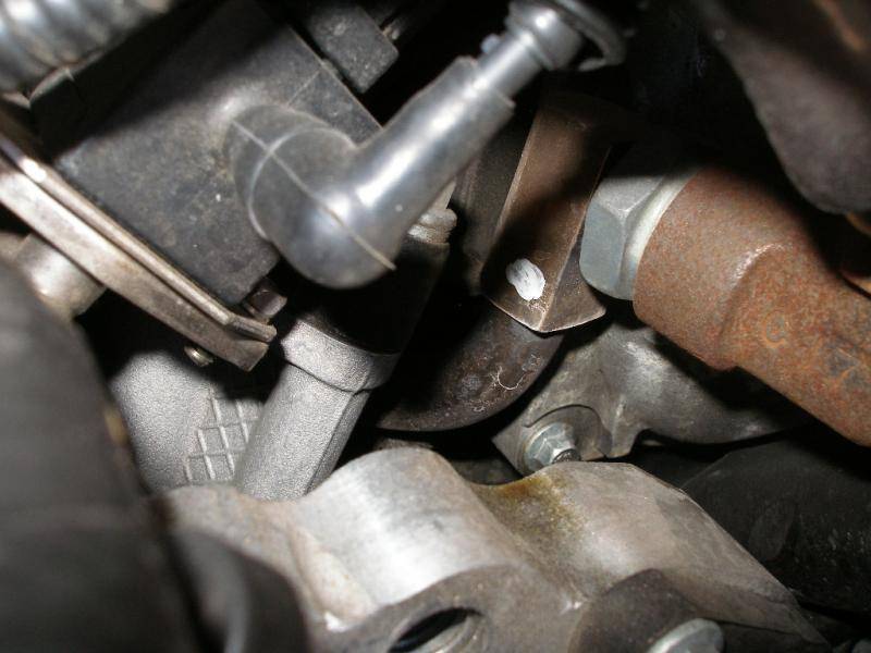

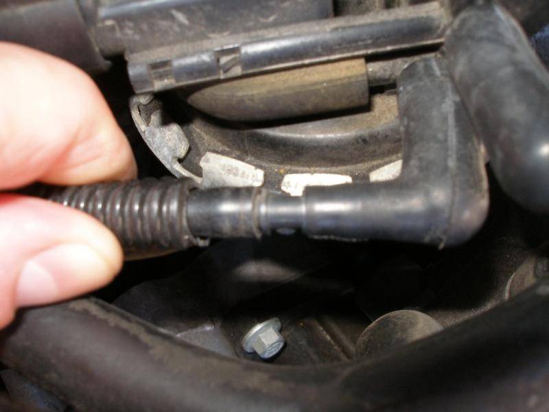

I need help identifying the part below. It seems to be some kind of hose. One of those hoses broke so I need a new one. The hose broke very easily, it snapped almost immediately after touching it. You can't really see it but there's another hose under the red one, that's the one that broke. I just need to know the name of the hose I'm touching in the pictures below so I can look it up, and Can I still drive my car like this?
They are the hoses for the EGR Valve - same thing recently happened to me on my 2006. Yes you can safely drive the car, however, your check engine light will likely come on. I searched for the parts in question and found them attached to a full used EGR assembly on e-bay. Took a gamble and they were in good condition and I replaced. Check engine light went out after a brief battery disconnect. May want to call Tasca to see if they can assist
Vacuum hoses. You should have a CEL and EGR code. Just run down to NAPA (or your favorite parts store) and get the appropriate size vacuum hose and some connectors. Use the stock connectors where they terminate on the stock pieces. IIRC I spent something like $10 for all the "T"s and straight connectors to make my own harness.
