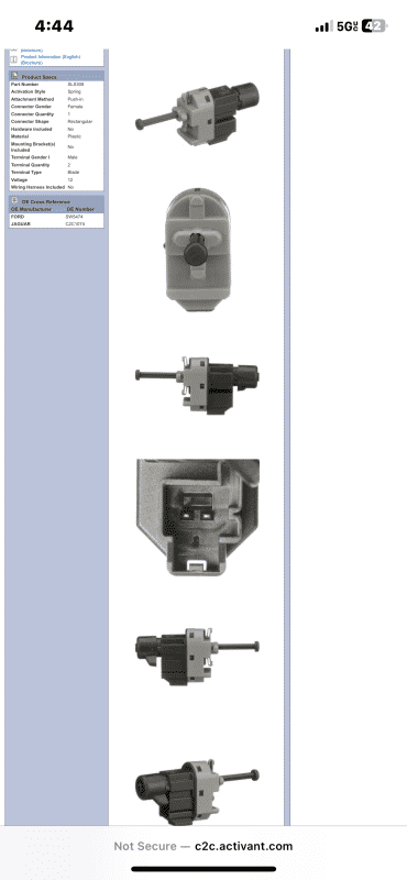

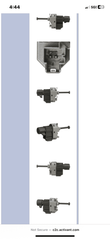

I think this is it but have no clue it says it’s a brake light sensor
Your pictures are showing the brake light switch. Look up under the dash on the driver's side, and you will see it there. Note that it is supposed to be a one-time install. If you remove it, you are supposed to replace it. This is because an internal adjustment to the plunger is made when the switch is first seated.
It's unlikely to have anything to do with a parasitic drain, and it doesn't really have much to do with the e-brake.

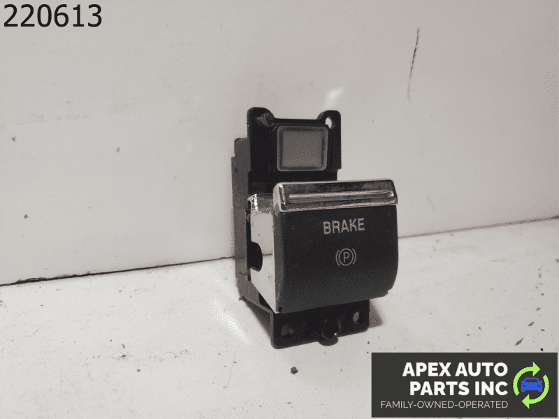

The E-brake switch is the assembly in your floor console that you pull up on to set the brake and push down on to release the brake (though it also auto releases). It also has the yellow E-brake fault warning light. Those switches do fail, especially in hot climates. The little plastic parts get brittle and break. Good luck finding a working one. They have been out of production for a long time now.
You can verify if it is your parasitic drain by unplugging it. While unplugged, you'll have no E-brake, but it will be a good way to verify if this is really your problem or not.
Search in Car-Part.com. I found my turn signal switch at the best price available at Mills Auto Parts in Ft. Wayne, Indiana; Tel 260-493-1553. They had my year Lincoln LS and they pulled the switch from the car and shipped it to me.
If that doesn't work maybe you can retrofit a similar switch from a different Ford model.
