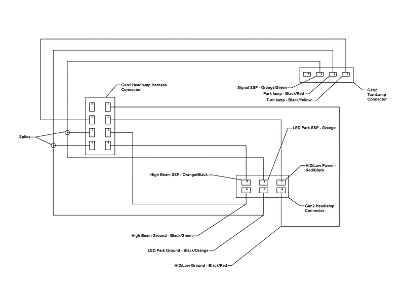

Hey my fellow car lovers!! Hope all is well. I joined this forum because iam a pride owner and lover of a 2002 Lincoln ls V8. Iam currently in the process of convertimg it to a 2006 LSE. I have everything i need, just having some trouble with the light swap (gen l to gen ll). The wire harnesses are giving me trouble. Iam very aware that many of you have done this before. Any and all help will be appreciated. Thanks in advance!!
I assume you're talking about the headlamps? If so, you are in luck, I spent the day creating a wiring diagram:
Please note, this is for the DRIVER'S headlamp, the Passenger's is similar, but a few of the wire colors are different. The large 8-pin connecter on the left is where the original headlamp harness plugs in, the 2 connectors on the right are from the 2003+ headlamps. You'll need to splice the turn signals together in order to keep the LED Parking light in the headlamp.
