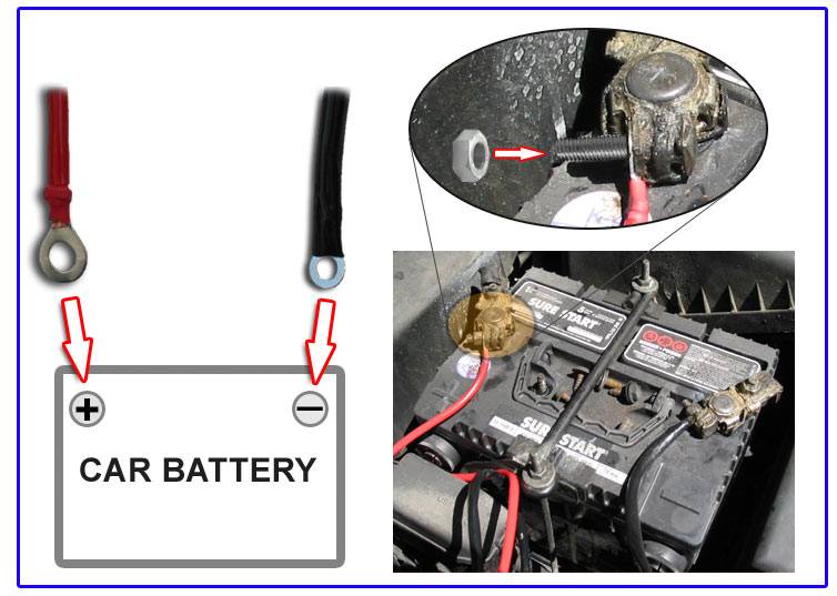

I am new to this board, I was wondering if someone can help me. I purchased a HID conversion kit from "vision bulbs." They have install instructions on their website, but they are not for a LS.
What power source do you use for the kit, since the battery is in the truck? Also, where does the kit connect to the stock wiring?
Here is a link to the install instructions......http://www.visionbulbs.com/vb_installg.php?id=8&dmv=6924511689#

I have to plug in the power wire to some kind of power source. Where is this power source? The kit is designed to plug the power cable directly onto the battery terminal, but since the battery is in the truck........I don't know where to plug it in.
One suggestion, is the back of the alternator. Is there any other suggestions?

Looking at the link I provided......they hook a power wire directly to the battery terminals in step 6.
Can I skip this step then?
They might be selling a relay kit or something with it to make sure the headlights get "full voltage" Mine came with the relay harness, and in the instructions it said you have two options, hook them up to the stock pigtails and put a bigger fuse in the fuse box (which is dangerous) or use the provided relay harness to go straight to the battary and use the stock pigtails as a turnon. I Used the stock pigtails for power and all and didnt touch the fuses, still working wonderfully
Cool, thanks for the reply. I went out and hooked them up to the stock harness. Man was that easy.....15 mins. Should I leave them on for ten minutes to break them in? Or is this not required?
