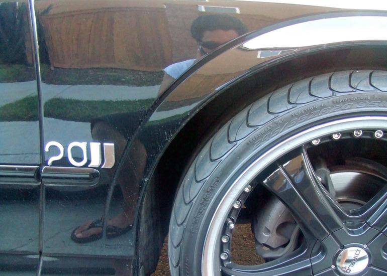

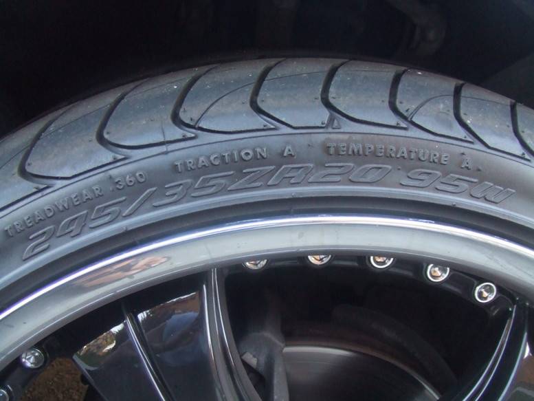

I just recently put a set of 20'' rims on my LS and had to take them off because i they were going to rub with the rear fenders. They seem to stick out just enough to catch the inner side of the rear fender. Ive been looking and searching posts over the last couple of days and really havent found anything that would help and I really dont want to roll the fenders. Ive heard of spacers and other ideas but were would i go to get them. Ive also tried to find if i could find a small lift kit or something or maybe some bigger coil springs. If you have any input id greatly appreciat it. The Tire Size is 245 35 20.

You can try to roll the lip on your rear fender, our fender has a small 1/2" lip on the inner side and I'm about 90% sure thats where you are rubbing.(I know you said you didn't want to do that) I have had two sets of 20's on my LS the first set rubbed with the same problem as you only once in awhile, didn't really bother me and didn't cause any damage to the tires. I beleive Grayghost1(ken) had some spring spacers that he was gonna use PM him to see if you can help you. That may fix it. I now have the Foose Speedsters and with a fully loaded car w/ppl I haven't had any problems. I'm not really sure about this idea but you may be able to have an alignment shop adjust your rear camber, but it may lead to tire wear issues in the long run. Post what type of wheels you have as well this may help us figure out your offset. And a final option would be to possibly try to make your sub box smaller. Just an idea. I have a custom box which holds to 12's which was made to fit under the rear deck speaker/amp housing. I have since sold my speakers but still have the box.(check my photo garage for pics) When I removed the box you would suprised at the noticable difference in handling without the weight in the rear of the car. Sorry for the long post just tryin to give you some ideas.

Rear camber is not adjustable, no matter what anyone may tell you. The offset on those wheels is too small. You really need 45mm or greater offset. The stock offset is a rather high 60mm.
