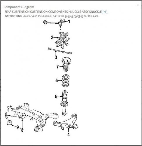

Hi community I need some major assistance, on finding out the part number and name for item 2 in the diagram below. This part broke on me on 4/18 as I was driving heard a loud pop and then several after until I reached the mechanic. My mechanic stated that he could get one from a salvage yard or order one from ford at a higher cost. Of course I want to get one myself even if it comes from a salvage yard or if I order it online. I need to get this done as soon as possible given that this is my daily car. So in the below diagram I need to know the part name and part number for item #2 in the diagram. Also I need this for the right rear. I have a 2001 LS Base V8. If you guys know of a website I can buy this part only or any info would be great. I have found that you can buy the whole assembly but I do not need the entire assembly just that one part. Thanks guys!

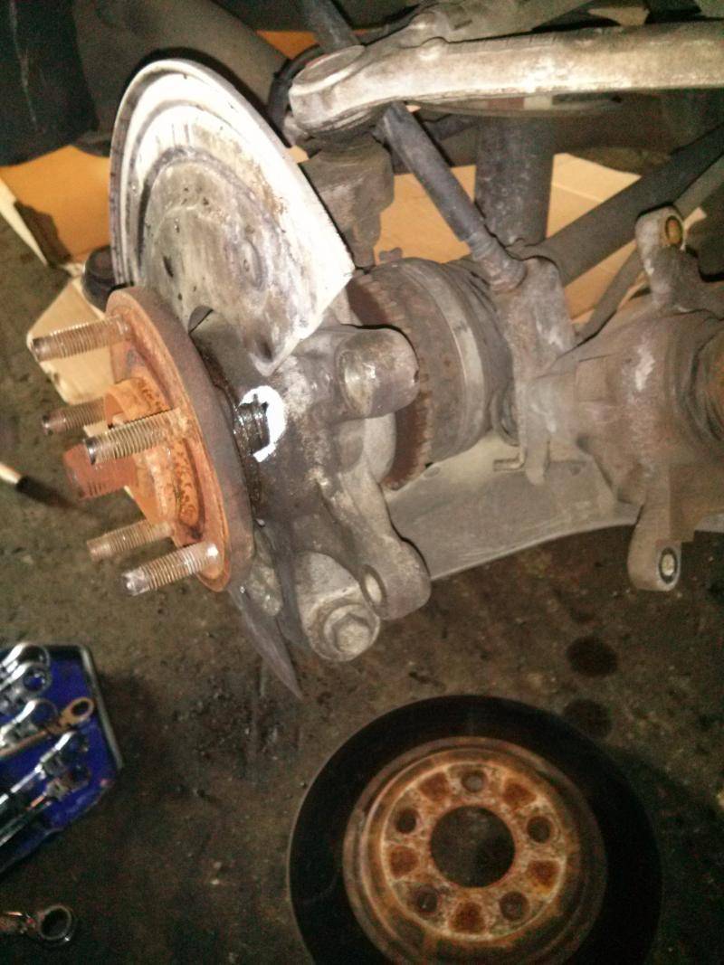

Here are two photos of the issue:

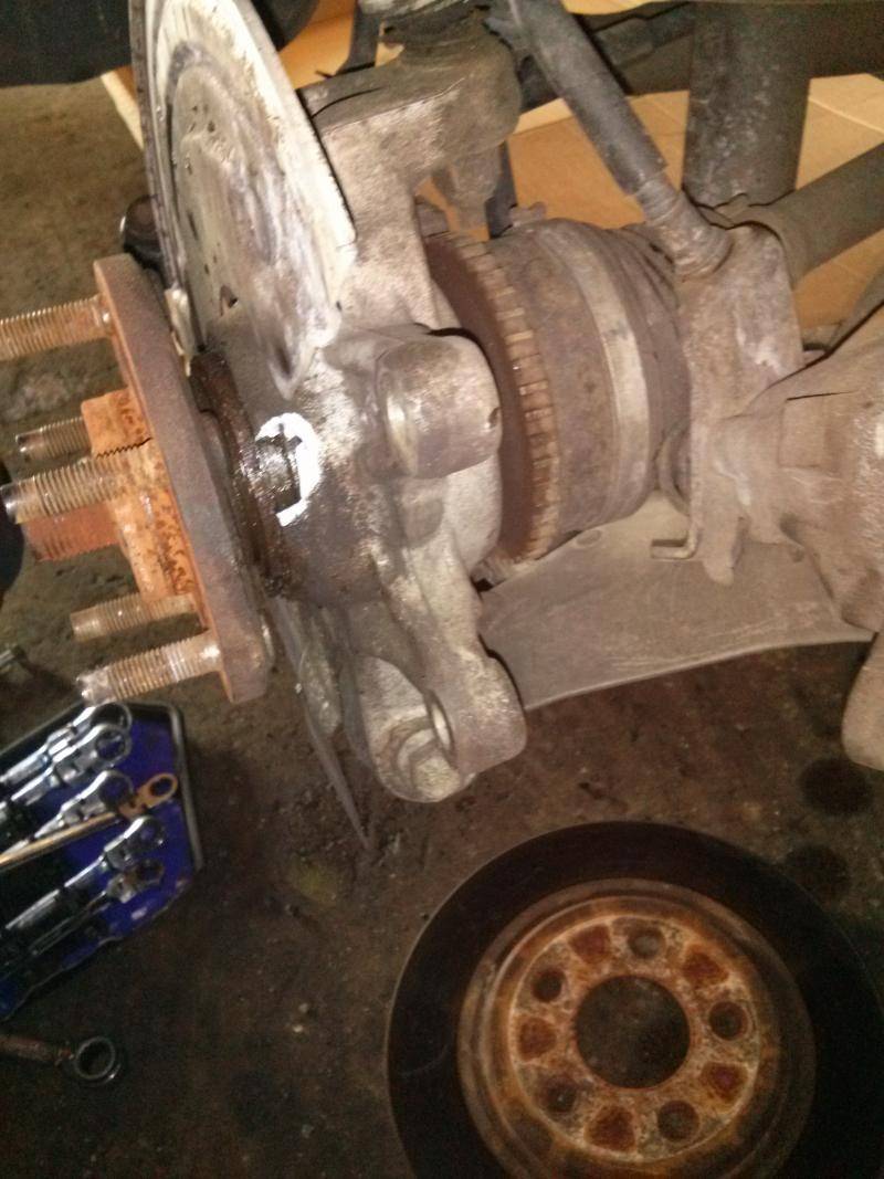

Another photo:

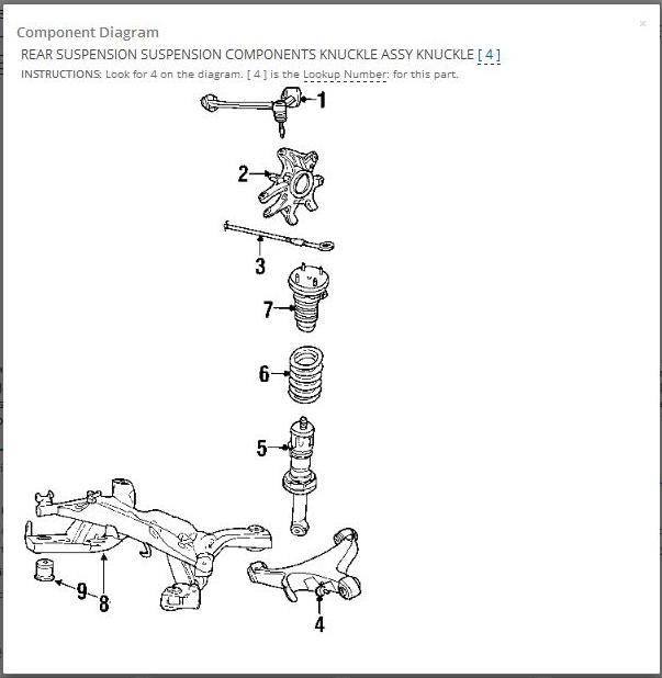

This is the link to the workshop manual. It is for model 2006 and I don't know whether there are changes in suspension parts between your 2001 and 2006. http://deneau.info/ls/
The drawing in the rear suspension exploded view shows this as #8, P/N 5A968, Wheel Knuckle and Wheel Hub Assembly.

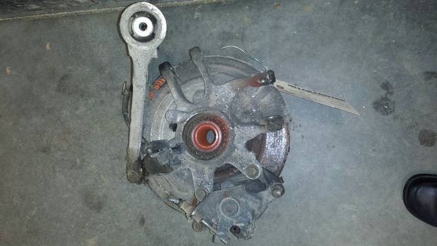

I found this part called a local salvage yard and they took the part of the car for me! Total cost $50+tax about $54 in all, I was so relieved that I was able to find the part and even better it was not $700+. So I will see how this turns out once its on and I have a chance to drive it around!
