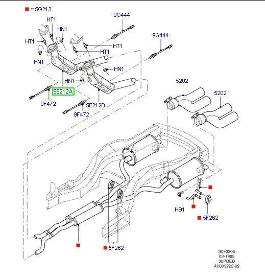

you know your car has 4 cats right?
2 on the right and 2 on the left.
it goes exhaust manifold bolted to cat section (has 2 cats), then a slip joint into the tailpipes back to the mufflers.
I would just replace them with factory if they are indeed bad. Why do you ''need'' them.

well, i called the dealer this morning, they said that there wouldnt be a problem cutting those cats and welding new ones, im going to get the magnaflow obd II compliant hi flow cats.
the car does not have 4 cats, it has 2 cats, 2 resonators, and 2 mufflers. has anyone else changed just the cat??

AFAIK, factory cats are the only ones available. I had to have one replaced on my V6 about 18 months ago (don't ask :frown: ). I called around to all the muffler shops and none were available. Magnaflow did all the prototyping for the V6 cat back system on my LS about 4 years ago (I got a free system for losing the car for 2 weeks :dancefool : ). I asked their flow engineer then if a higher flow cat would be worth the cost. He said "NO" as the LS already had a pretty high flowing cat. IMHO, just go with the factory cats (and yes, the V6 has just one for each bank) and you won't have to worry about fitment or any other issues. BTW, IIRC, I paid ~$500 for the cat. I'm sure Bill Jenkins at www.teamfordlv.com could get a better price.

XW4Z-5E212-CC List $573.25 LVC $426.84
XW4Z-5E212-CZ List $602.20 LVC $448.40
