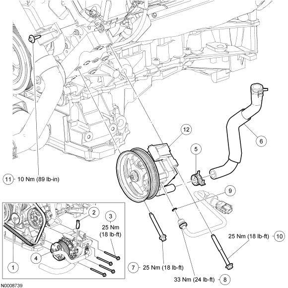

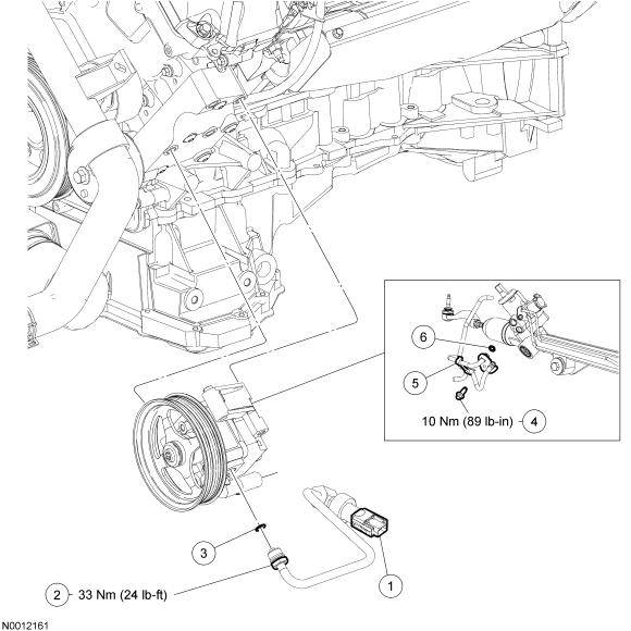

I can't figure out how the power steering high pressure pump line where routed orginally. I notice the metal arm that is attatched to the pump can only "sit" 2 ways so it's out of the way of the ac pump and other engine parts and both ways won't allow the line from the gear to attatch. Where do I postition the connection between the power steering pump metal arm line and the high pressure line from the rack?
Also does anyone know if the power steering pump should have a wiring plug going to it? 2000 v8 ls.
dont know if this helps but these are pics of the pump area and lines
