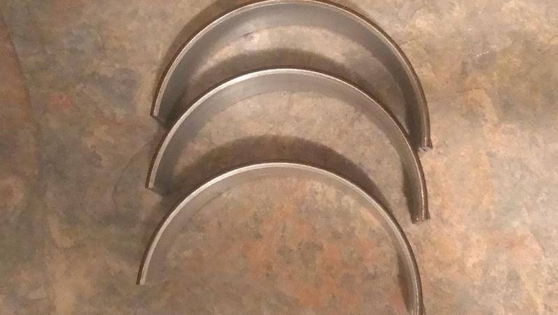

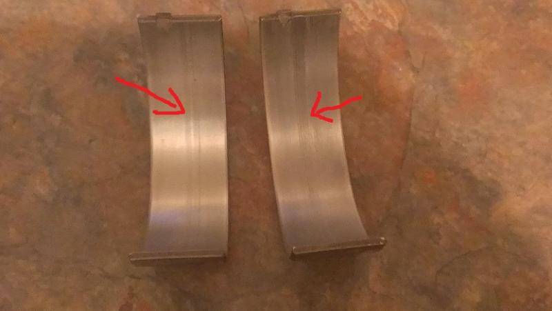

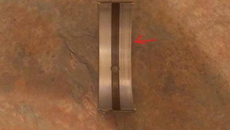

I posted a Thread last week on looking for engine main bearings for a 2002 Lincoln ls 3.9 engine and someone suggested to use the same engine bearings as the 2002 Jaguar S-Type 4.0 uses, Well I call the Jaguar dealership to order the upper and lower bearings and the problem that I ran into was that they wanted the vin number or the color thats on the side of the upper and lower bearings. Has anyone here ever use the 4.0 engine standard main bearings for a 3.9 engine if so what color is on the side of the upper and lower main bearing or if someone has information on Jaguar S -Type 4.0 engine bearings colors it would be highly appreciated, I'm thinking I should just go online instead of the Jaguar dealership and order the standard upper and lower bearings for the jaguar s type 4.0 engine.

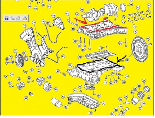

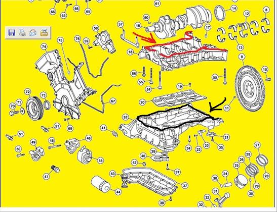

The next question that I have is about the engine gaskets for the lincoln ls 3.9 engine. I've order a complete gasket kit for the Lincoln ls 3.9 engine at least thats what the seller on Ebay claims it to be and after overlooking everything all the parts and gaskets seems to be here except for two I think, can anyone tell me if the parts in the picture below that's outlined in red and black calls for a gasket whether if its blue silicone or a gasket maker type sealant?
