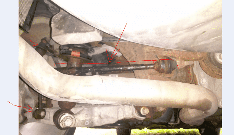

The two parts in the picture, I need clarification on the names.
From my understanding that is the rear sway bar link and rear tie rod correct? On parts geek.com they also list a part called a stabilizer bar but only have it for the left side. is this the same as the way bar links? some list sway bar link as "swaybar/stabillizerbar" so I am a bit confused. As you can see from the pic all the suspension parts need replaced but the two highlighted parts are what I am after first. I tried to run a search but with the generic terms I have I got nowhere. Thanks in advance for your help.
The one on the left is the stabilizer bar link. The rears are side specific. The long one is sometimes called a tie rod but the more accurate term is toe link. They are not side specific but there are only two companies that make them: Motorcraft and Deeza. With the latter, you lose passive rear steer. There are a bunch of threads on that.
There are several options for the stabilizer bar links but it's generally best to stick with Motorcraft or Moog.
