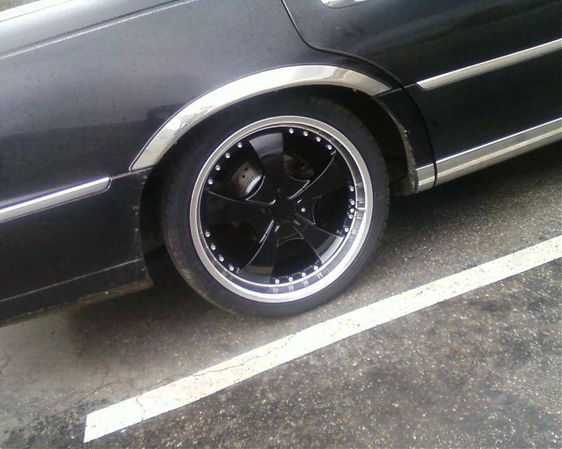

Okay gonna get some new 20's this spring.... what do you recommend the best for riding quality. I dont mind the ride quality i had with my dubz. Just wondering what you guys are running 20X8.5, 5X108... with 40 offset? Kinda new with wheels since my car came with the rims.... So give me what kind offset, what size rim, and what size tires so i can have a good ride quality and keeping it sexy at the same time.:)

Give me what kind of offset i need for the ls, what size rim and what size tire so it doesn't rub and rides good. Im pretty sure its 5X108, 20X8.5, and 245/30/25..... i think...

5x108 or 5x4.25"
20X8.5
245/35/20
if you want rims get 45mm offset, and run on 235/35/20 that will be almost the same size as stock for your ls and should provide almost no rub
245 35 20 tires and I have a 42 offset car is lowered and the back tire has been completly tucked no problem:D

That is an odd tire size. Good Luck finding tires.
If you want to stray from the 245/35/20 then go to 245/30/20

You need 20x8.5 wheels with an offset in 40-45mm with 245/35/20 tires. The 45 offset would be the better one as would eliminate the possibility of rubbing. The 245/35/20 is the best tire size to use.

Thanks man, yeah buddy had those dimensions on his 03ls never got rubbing either. 20X8.5 with 40mm offset.
one quick question would a 38 offset make any difference? I found some really nice rims i want its 20X8.5 and 5X108 but has 38 offset. That guy told me the car ranges from 35-45mm offset. Would 38 make a huge difference in the ride quality or i have to get a 40-45 as most people suggested. Any feedback would be awesome

I would think if you go over a big bump it will rub or if you have alot of people in the car.... If you want to lower your car at all DONT even try it with that offset... but just driving on a road should be ok
Not going to lower it or anything, i barely ever have passengers in the back. So you think 38 would be fine then. The guy told me 35-45 i should be fine is this true?
anyone?! I really need to know if 38mm offset will make a huge difference i dont care if it rubs here and there. Plus i never have people in the back and the pot holes aren't that bad here. The guy told me 35-45 should work is he right? I was thinking 40-45 and maybe 38..give me opinions pplz!
