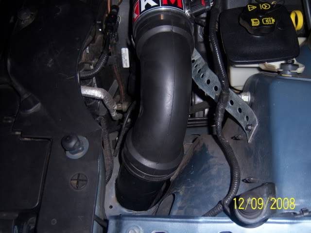

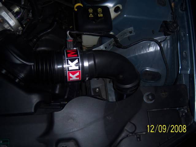

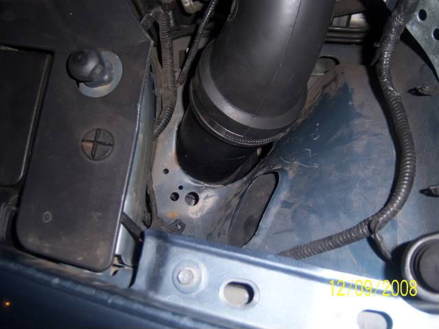

I dropped over a 100 degrees in air charge temp from putting my stock kkm intake in to the front bumper, making it a real Cold Air Intake, not a hot air short ram like mrshl13 was talking about... my car now is much better out of the hole now and accelerates smoother... but i have a gen 2 not sure what yours is... I'll post pics...
here it is!
my PC is screwed up, I cant upload to Photobucket or to the site..........
HA got it!
the Rubber Elbow cost me 6 bucks at home depot... and the black PVC pipe cost me 4 dollars for 2 feet and the KKM cost me 90 bucks on EBAY! all to gether 100 dollar cold air intake... you just can't beat it!
oh yea and 2 minutes with a Torch to cut off part of the "support brace" on the radiator support for clearance for the PVC pipe and filter
