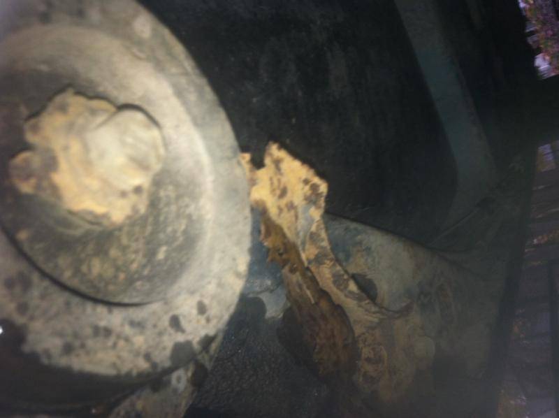

The braces are just steel supports going from the frame to the rear cross member. They connect to the cross member on what looks like a rubber bushing with one bolt thru the middle. Idk if that description help.
Yes it does. I will look under the 3 MARKs here in the yard and see what shape they are in.

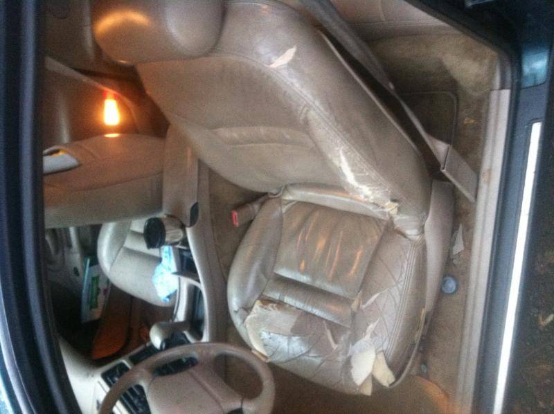

As you can see the braces are nonexistent and my seat it in bad shape. Still comfortable just looks terrible.
And I uploaded them from
My phone so idk why they're upside down but you get the point haha
Typical Northern car! Those braces vanish after a few years of Salt and Chloride!
Are you sure you want just the tracks or the entire seats? :)
