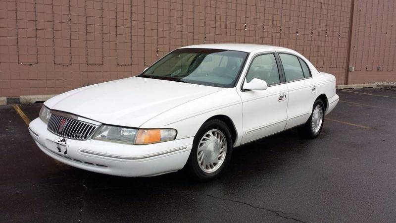

Hi all! New guy here looking for some tips and advice. I have a 97 Conti that I picked up in January and I absolutely love it for a daily driver on my 30 mile commute(the fact that I got it for $500 and have only put $500 into it since then might help too!)
