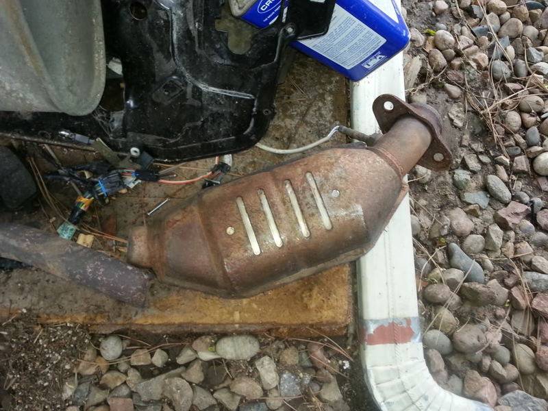

Yeah it sucks! I have to undo the exhaust mods I did. Trying to track down a passenger side CAT that has not been chopped up.
This one? Name your price
