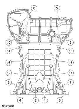

I have an oil leak as well on my 2004 Lincoln LS V8. I was reading your response and your always on point. I may replace oil pan gasket my self, but its a little cold out here in TX, so I a little lazy, LOL. If I decided to let a mechanic do it, can you elaborate more on why some of these mechanics keep quoting there are 2 oil pan gaskets on the V8, and it is more expensive to get that repaired, compared to the bottom oil pan being repaired. From reading your post, are these mechanics getting the V6 Lincoln quotes mixed up with the V8 oil pan repair quotes?
..., can you elaborate more on why some of these mechanics keep quoting there are 2 oil pan gaskets on the V8, and it is more expensive to get that repaired, compared to the bottom oil pan being repaired. From reading your post, are these mechanics getting the V6 Lincoln quotes mixed up with the V8 oil pan repair quotes?

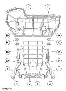

The V8 "oil pan" gasket is very easy to change. If this is where your leak is, then you have no worries. Unfortunately, the V8 oil pan is not like the traditional oil pan that you might expect, it does not cover the entire bottom of the engine. Instead there is another piece that is just above the oil pan and does run all the way to the back of the engine. The service manual calls it the "sump body." It is much much more difficult to remove and reseal with the engine in the car. (The service manual only shows doing this on an engine that has been removed from the car.)
Sump body
The area at the top (with numbers 5,6,9, & 10) is where the "oil pan" is attached to the "sump body."
Oil pan
