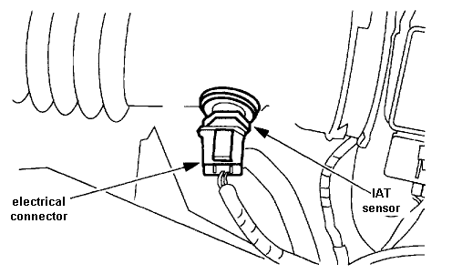

Is the IAT built into the MAF on these cars... 03 ls V8... if not where is it located...
Everything you ever wanted to know about your 2nd GEN is available
in the online workshop manual located here: http://deneau.info/ls/
On 1st GEN it's sensor is located directly after the MAF,
... not sure on your 2nd GEN, have a look at the manual.
Yes, the IAT is built into the MAF on gen II.
