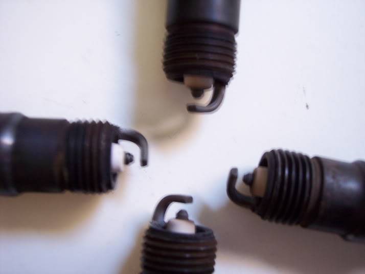

It seems that every 5k i have to replace my plugs or the car begans to give me attitude. I was gettin CEL's like crazy this last week, so i figgured...wtf not, ill replace the plugs for fun if nothing else. so i do and it smooths out pritty good. the plugs i took out didnt look bad at all. what is up with my baby? is she just hungry?

What plugs are you using?
what do your plugs look like when you take them out? their appearance should be able to tell you exactly what is causing them to be et up.
Using the AP 764's (autoliteplatinum)
they look a little like they are a very little corroded, but im guessing thats just from the heating up cooling down.
ill take a pic and post it later tonight.

I also had the Autolite single platinums. The ceramic insulators looked just like yours, kitchen white along the sides, with a slight light tan coating on the top face.
