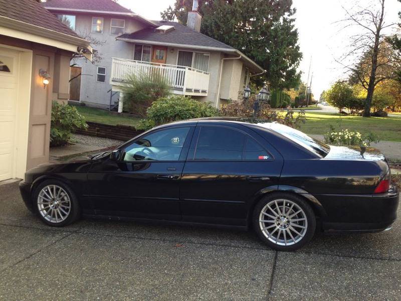

I put some new KYB struts and Eibach springs on the LS yesterday, and couldnt be happier!The car handles noticaebly better, and looks 100% better! if any of you guys have been on the fence about lowering your ls...DO IT!

Truer words have not been spoken! Lowering the Ls is an absolute must! I was looking at pics of my Ls before the drop and just thought ewwww.

the car looks great.
Are you 100% sure those are KYB struts? part #? any issues installing the springs on the struts?
When i orderd my eibachs off tirerack a couple of years ago i also ordered a set of KYB struts but the guys from tirerack called me saying there were "compatibility issues" with them and that i should not put the eibachs on the KYB struts (At least they were honest) So now i have almost new motorcraft struts in the front, but i think the rears will need replacing soon and I'd like to go in this direction if there are no issues...

Am I the only one here who's wondering why nobody has mentioned that they're not struts?

Sorry I totally forget that we tried to order the KYB struts but they didnt have them..ended up going with the monroes..that whole day was a bit of a blur as I had 20 other things going on...
No.... and it drives me CRAZY :rolleyes: Same with "we need coil-overs". We ALREADY HAVE coil-overs.
I had the Monroe SensaCraps for a couple months. They were TERRIBLE and I replaced them with the factory shocks.
