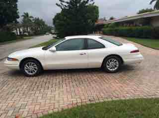

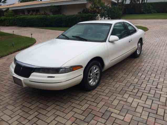

I wanted to introduce myself and my ride. I'm getting a '95 Mark VIII with less than 40K miles that belonged to my grandmother and sat in her garage untouched for years. I'm rather excited, as I've owned and modified a supercharged '96 Cobra for 15 years, which has a similar engine. Known issues is that the battery drains (alternator?), the rear drags (air leak in the suspension?), and the trim around the rear window looks like bacon (I might need to call a window glass company). Once I get these issues resolved, I'd like to make some modifications to bring it up to date. I am considering a hub swap to make the wheels interchangeable with the Cobra (any good threads on this), but it seems like tirerack.com offers some nice wheel combinations. If anyone knows of good threads that detail how to correct these issues or advice on how to make this car better, I'd appreciate it.

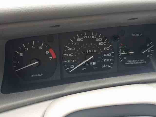

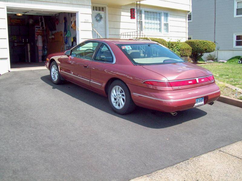

95 lin.jpgWelcome BOBC, You say the back drops. The compressor draws a lot of juice, and it might be trying to fill the rear bags. Check for 14+ volts at the battery running. Check the battery post clamps, my 95 had a cracked one + side, mostly it ate alts. A member here sells stick on moulding that covers the bacon. He's working on some that will work if you cut it off= T- moulding. You can cut it off, and it wont leak, it's part of the rear glass. About $600-$800 to replace it. (pic of my 95 cut). WOW 13K miles. Where was it shipped from? You might have issues with the headlights. Try them at night. Can you tell their on? Click on search thread above and you'll find lots of info about these cars. There's lots of good guys here that will help. LOL with your new car. TONYyyy
