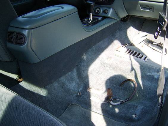

Try lubing the seat track with white lithium grease or similar. You may just have to replace the 6 way motor assembly, though. Not too hard...
You will need to pull the seat(s), though. This was easy in my car as it is completely rust-free. If your's isn't, expect to snap a seat bolt or two!
http://www.supermotors.net/vehicles/registry/7603/58527
