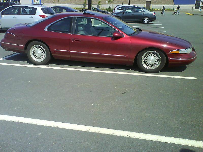

Hi everybody!! I have a 93 mark VIII with 49000 miles on it with no rust. I bought it in October drove it for 2 weeks and then put it awway for the winter till April. What a long winter that was.
This site has helped me on a few things before but i cant seem to find a related thread for my issue. On my 93 mark this happened twice now in 3 days when i start the car it goes trough the system check and it says Check Air Suspension and the compressor wont come on. If i drive it like that the front passenger airbag will deflate quite a bit. If i turn the car off and restart it the compressor comes on and the Check Air Suspension error is gone. When the car has been sitting for 12 hours it seems that the front passenger side sits 1/2 inch to 3/4 inch lower than the drivers side. Anybody have any idea what is going on?
