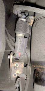

I have no clue about this... Any info on this would be appreciated. I would like to get my mark VIII out of the air for the most reasonable price.
look up
On mine I re-drilled the two bolt holes about 1/2 of an inch higher on the front sensor bracket to get the front to drop a little more.
For the rear if you need more drop I guess you could just use the top bolt.
The tech articles link has a few goodies.
gotcha. thanks guys. Im still a little confused after reading the write up in tech articles. I think its just going to take me having to get under the car and look everything over to see what exactly Ill be working with.
Its been raining non stop so that'll have to wait a little while.
