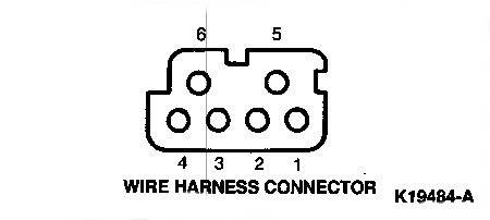

As for your compass....hopefully you have a multimeter.....that is what it is going to take to test what is wrong with your compass.....here is what you will need to do:
1) Disconnect the 6 pin wire connector on the compass module in the trunk.
2) Check for 12 volts between pin 3 (white with pink wire) and ground (key must be in the ACC position.
3) If there is no voltage then service the white with pink wire for an open circuit. If there is 12 volts then continue on.
4) Measure resistance between pin 5 of the compass module and pin 35 of the message center. Check to see if the resistance is between 7000 and 8500 ohms.
5) If the resistance is not between 7000 and 8500 ohms then service that wire for an open. If the resistance is between 7000 and 8500 ohms then continue on.
6) Measure resistance between pin 4 of the compass module and pin 26 of the message center. Check to see if the resistance is between 1600 and 2000 ohms.
7) If the resistance is not between 1600 and 2000 ohms then service that wire for an open. If the resistance is between 1600 and 2000 ohms then continue on.
8) Verify ground between pins 5 & 6 of the compass module.
9) If the ground is no good then service the black wire for an open. But, if the ground is good then you will need to replace the compass module.
Hope that helps.....
