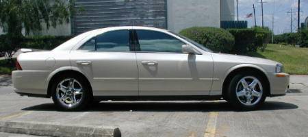

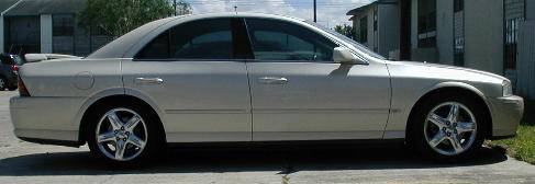

Well, I instaled the spring yesterday in about 5 hours (3 hours on the front and 2 hours on the back). Not to hard. What a difference it makes in just the overall look.
One thing that I did find for anyone that does they in the futher, on the rears you don't have to compress the new spring to put it on. Just use another person to put retaining nut on while you put a little weight on the spring assembly. That will save some time.
Anyways here's the before and after pics.

Welcome to the Eibach Spring club! You're gonna love your LS even more now since you have it lowered. It'll handle better than you'll imagine. Your LS looks great too. As stated above don't waste your money on the camber kit. Just keep your tires rotated at every oil change and you'll be fine.
