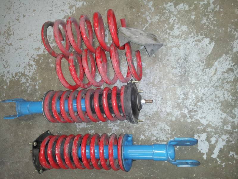

Sounds like a portion of your air ride has reached the end of its life, could just be leaky bags. For piece of mind you could swap to springs.

I have a set of lowered springs for a Thunder bird, I believe they are a 2" drop. They are a Tokico shock and Tokico Spring setup. I have 2 perches for the rear springs, these perches are the plate style ( a piece of plate steel, bent to hold the springs with a stud placed in the center) not the fancy puck style that fits inside the spring.

If the air ride problems are beyond your scope as a do-it-yourselfer you could always convert it to springs. You could probably do that yourself.

It is. Fronts are Suncoast's about 4 years old. Rears, not sure of age. Compressor is one I picked up off Ebay (original and questionable condition), and I only top off air once a month. I leave the compressor shut off. My drive to work is silly with the auto drop. Drive 60 for 3-4 miles, hit light. Rinse, repeat for 20 miles at highway speed.
