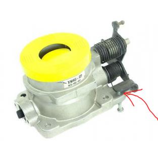

Ignore the videos since they're probably wrong, the above tech article has always worked. To hold the specified engine idle, I usually stick 2 coins in the throttle body here
