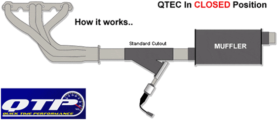

you could always to cutouts -> http://www.pfyc.com/store/merchant.mv?Screen=PROD&Store_Code=PFYC&Product_Code=GN5002&Product_Count=9&Category_Code=MCEXH
you would leave your stock exhaust in place then flip a switch - and have straight pipes...:Beer

lexdiamondz10304 said:
So, what does this exacly do?
allows you to flip a switch and shunt the exhaust out bypassing the mufflers - increasing hp.
Very cool stuff and make a really quiet car loud very quickly.
