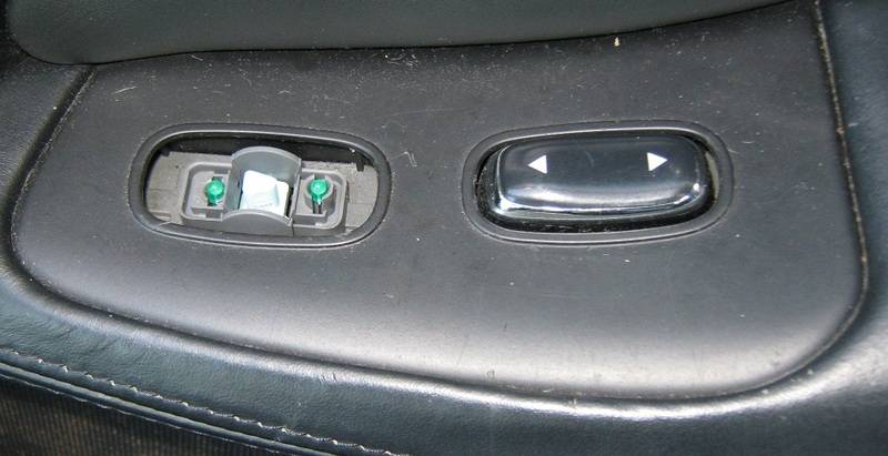

The only thing I'd done to the car between shutting it off yesterday and turning it on today was prying out the switch lever from the passenger side door. The cap is gone, so I pried it out to glue it.

Update: The lock pictured above.
I pressed the switch in, and now the power locks and keyless entry pad don't work at all, ever, regardless of key position.
I glued the switch lever back together and pressed it back down into the lock. As I was pressing, the lock was rocking back and forth and working fine: locks were locking and unlocking.
The last push, up over the rib and the switch snapped into place... the locks stopped working that exact moment.
How do I get the door skin off? :/
Edit, got the door skin off to fish for a short circuit. Is it normal for everything to not work once everything is disconnected? Putting the key in now does nothing at all.
