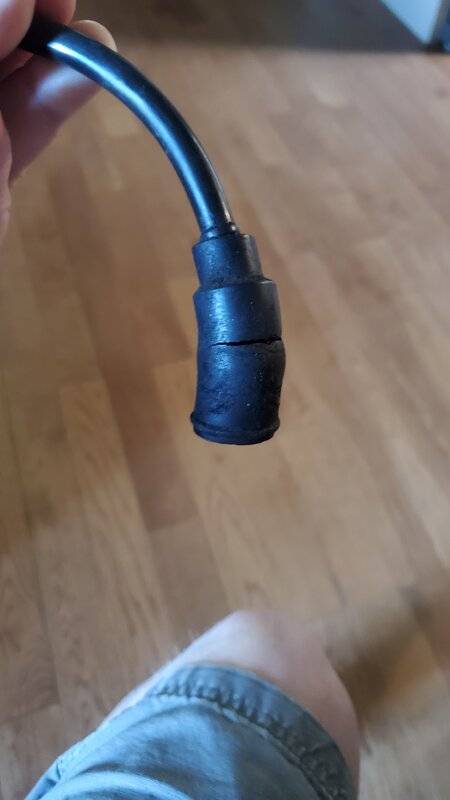

General rule with the V6, replace all 3 inaccessible plugs and coils when you have the intake off. Also, look for problems with the re-assembly. Ensure that the PCV tubing is fully installed and sealed as this also leads to rough idle if anything is disconnected or cracked. If your car has the throttle body tubing that connects to the pcv pipe at the rear of the engine using large diameter pipe to the 8 mm plastic tubing couplers using rubber transition adapters to connect the PCV pipe and throttle body fitting to the small plastic pipe, check for hidden cracks. I drove for a few years with one of mine cracked, but I am not positive on how this is set up on 2nd generation V6s.
