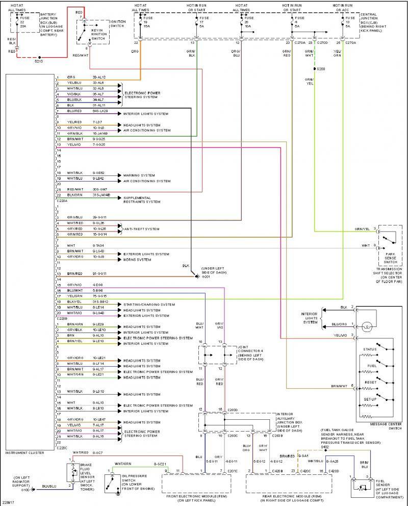

Got it, thanks. I assume there's no straight +/- wires that would turn on the display either, right? I wanted to see if the natural pale-blue color of the display (GM dash color) could be tinted to a richer blue color, without the dark green overlay. Juggling a disassembled climate control panel wasn't so easy last time I tried it and I don't want to take my cluster out/apart until I know exactly what I'm doing, but I guess I could tape up the CC panel and try again
+12V to pins 1, 11, 17, 3, and 6 (C220b). Ground to pins 13 (C220b) and 6 (C220c). However, I don't know if it will work without the connections to the light switch.
C220b is a 22 pin connector and C220c is a 22 pin connector, but C220a is also 22 pins.
Presumably, the plugs are labeled sequentially, placing -b in the middle with the 4 offset pins, which I think you meant is a 20-pin connector. Conveniently, the pins have some reference numbers stamped inside them. However, I don't know which connectors are -a and -c. Given the pins are numbered left to right when facing the female sockets in the back of the cluster, does that make the connector closest to the center -a?
