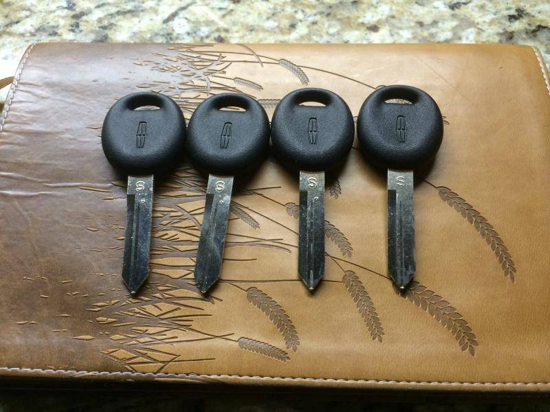

Dang, I just got 4 brand new OEM round-style keys a few days ago. They were all sold almost immediately!
