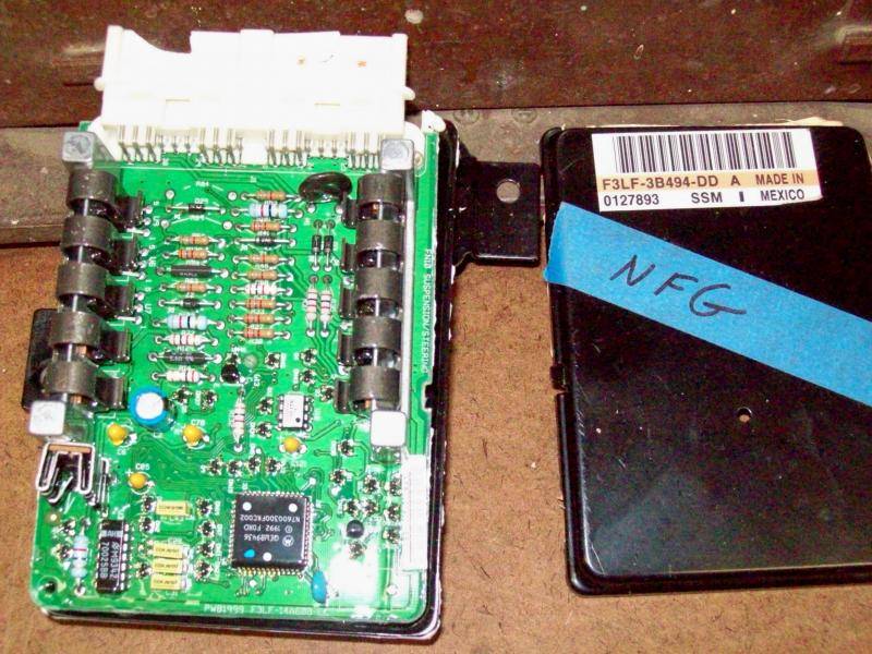

module
I'd try giving the module a few taps. Not venting could be in the abs system. The air system runs through a lot of stuff, height sensors,door switch (int lights), ABS system, speed. My 95 just bottomed out in the rear. Module fixed it. The module controls the system. A lot of stuff in it. Moisture can freeze in the system but I don't think it's cold enough where you are. Let us know what you come up with, vent or module?
