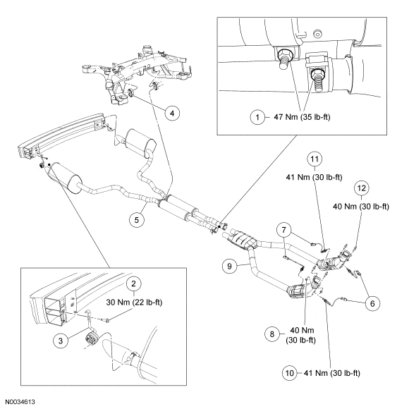

Does anyone have a work shop pdf or write up on how to remove the upstream o2 sensors? It seems mine are wrapped up along part of the upper suspension with black tape or something.
That's not factory then...
I may be wrong then, I dont see them anywhere, I see the end but the wire goes into what looks like part of the suspension, if you have a diagram or something that can point me in the right direction that would be amazing Joegr
