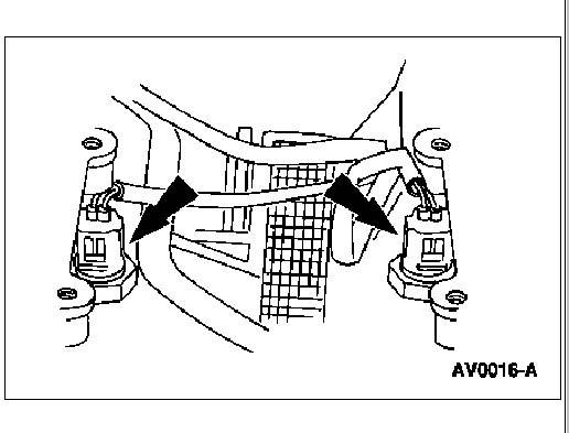

The 98' Conti engine does have dual knock sensors. They are located under the upper intake manifold.
From the 98' Ford Service CD...
1. Remove the lower intake manifold
2. Disconnect the connectors from the knock sensors (KS)
3. Remove the knock sensors.
And here's the picture...
JR
Seems easy, I'll try the Fuel filter first, if it continues, i get these sensors. I found a place where I could get each at $54 a pop.
