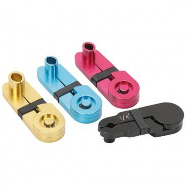

No such luck. It's behind the fender liner, driver's side front wheel. If you have a 2003+ you will need one of these, but I don't remember which size.
Have fun taking the fuel filter off. I had to double up a similar tool set.
