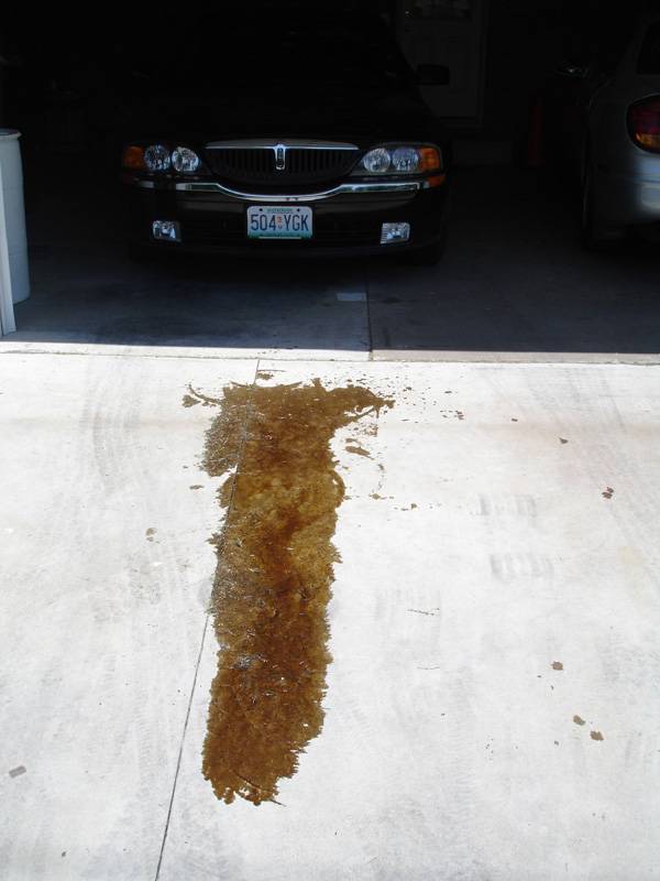

Looks like the Exxon Valdez ran aground onmy driveway.
gave me a reason to use the excess cat litter we had laying around.
Changed the oil today
old filter was installed with impact wrench, it seemed
had to use the old screwdriver and hammer trick
also had an overflow problem with the collection device.
