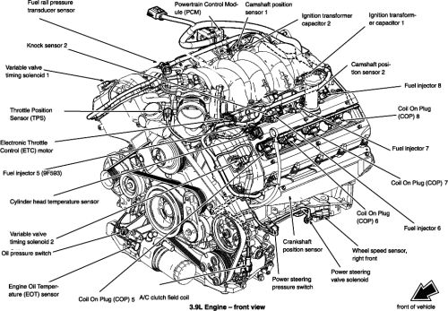

I have an 04 v8 LS that is leaking coolant from the oil cooler, does anyone know where I can get a new one? Or the part number?
you are talking about the part at the very bottom, dead center of the motor where the oil filter screws into right?
Thats the part I'm looking for. I found it and ordered it I just need to figure out how to remove the old one and install the new one now.
