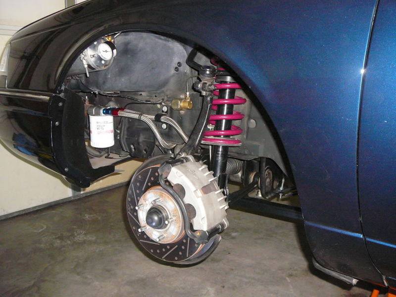

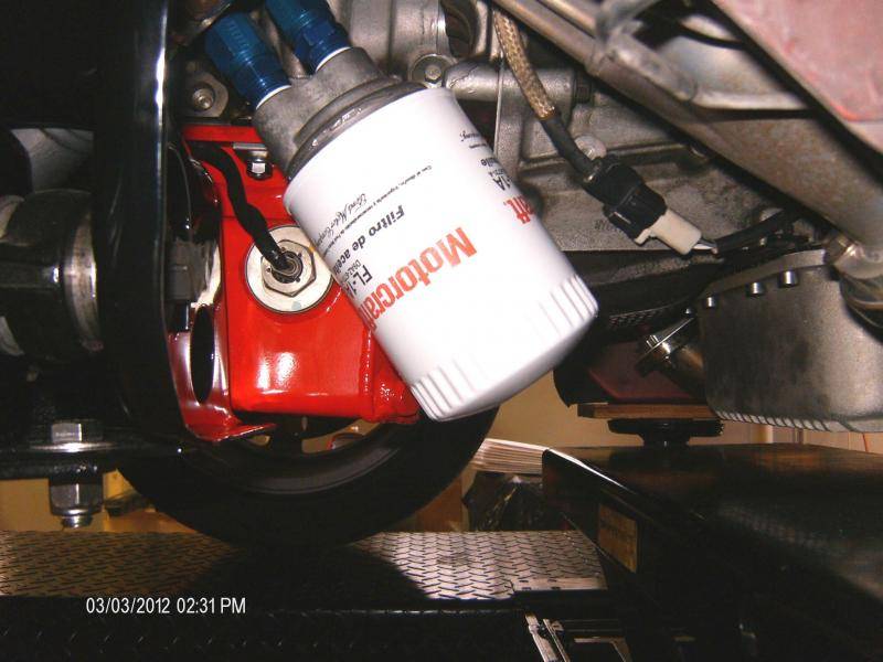

It's all about priorities. I went the non-ABS route to free up space in the engine bay on that car (and increase reliability), and I ditched the '97-based cruise control setup when I installed the oil accumulator. Having ~25 psi of oil pressure during startup was a higher priority than cruise control. That's a '90 Cougar, btw.

So you have to remove the inner fender plastic everytime you change the oil?? Almost better to just deal with the stock filter location if that's the case..or can you reach through without taking the inner fender out?
If you look closely, you'll notice that the fenderliners have been modified. I wouldn't be able to check the gauge on the oil accumulator with unmodified fenderliners in place. Accessing the filter is a piece of cake...no need to remove anything.
