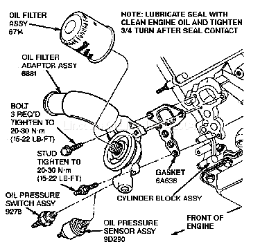

Its right below the power steering pump,right side of the engine facing it.Its behind the Serp belt.When you start the car cold it leaks pretty good,As it warms up it kinda slows.I think the oil filter is there,Is there anything else there that can be leaking?I thought maybe rear main when I first saw a small spot yesterday but this oil slick is coming right from the front of the engine.Im hoping like hell it isnt the oil pan gasket cause that would suck!
