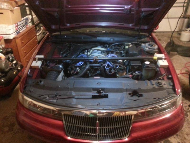

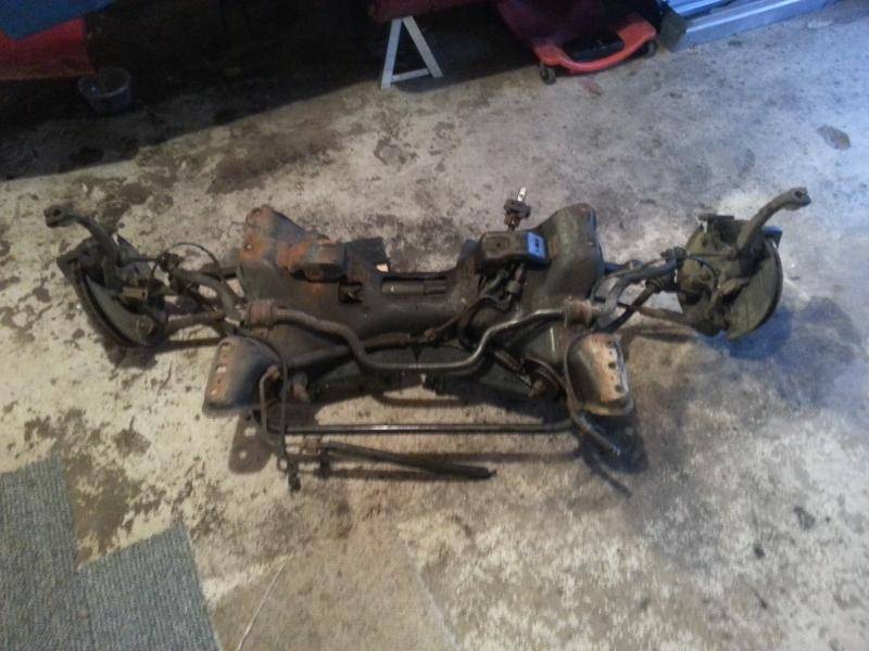

Best way to do the oil pan gasket is to use an engine support brace and drop the k member. The reason is the oil pick up tube hangs low, so you might want to wait till the transmission is in and working before taking on another big project.
How do I drop the K member safely? I kinda destroyed the back part of the gasket when i was putting in the new rear main but i would think that it would be better to do it with the trans out?
Same thing, just home made.
Once thats on and holding the engine, unbolt the suspension, brakes, power steering and k member bolts .
