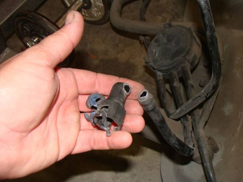

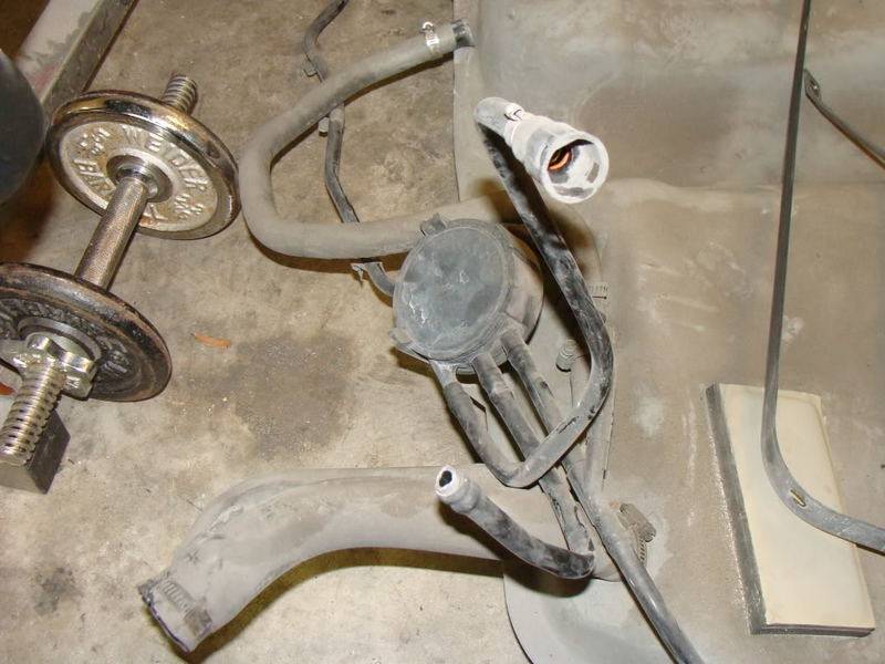

i need someone with a gen 2 they are partin to help me out, i broke 2 pieces of ripped camels fuel system on the gas tank, i have pics right here, i need these lines, or all the platic lines and the round canister off the tank, and the white piece that you see broken, please someone say they have these!!

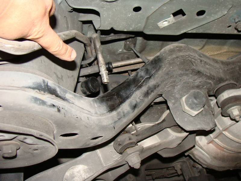

AND THIS IS WHERE IT CONNECTS:

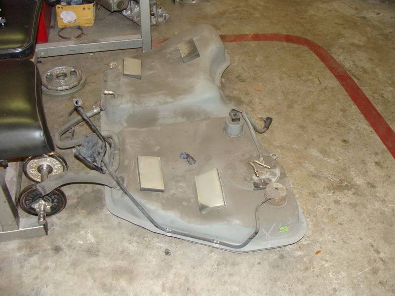

AND I NEED THE WHITE PLASTIC ELBOW THAT PUSHES INTO A GROMMET ON THE TOP OF THE TANK, YOU CAN SEE IT HERE. LOOKING AT THE GAS TANK IN THIS PICTURE, ITS IN THE TOP LEFT CORNER, NEAR THE WEIGHTS ON THE FLOOR.

i'm not sure if it helps man, but in that first pic where the fitting is broken, sometimes oreillys has a kit with all different kinds of those fittings with a tool that presses them into your plastic line. We have one at our dealership that came from oreilly's. Don't know if that helps, but maybe you could give them a call.

I have repaired those kind of broken fuel lines by using sections of standard high pressure fuel line and just using hose clamps over the fittings.
