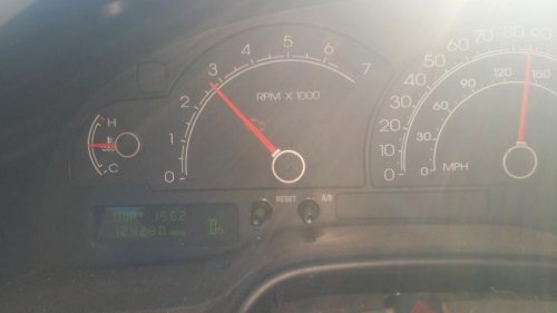

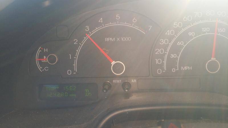

The main issue I'm having now is when you run the heater in the car, it overheats within a few minutes, and stays hot.
I've run it a few times (5-10 miles fully warmed up) without ever touching the Heater (or A/C) and it never rises above the half way mark. Before this started occurring it would overheat at idle after 5-10 minutes of running.
Took it by a mechanic whose done some work on it and he had said "Since it was running rough I did a block test and it failed"
Now I don't know if he actually did or did not do the test, but ive had 2 other vehicles with cracked blocks/warped heads and they over heated every time I drove it, regardless of weather/distance/anything.
I've looked through the forums and I didn't find anything on this issue directly, so any insight or suggestions would be cool.

No clinging/or abstract noise from engine. 14825363489161116713875.jpg
