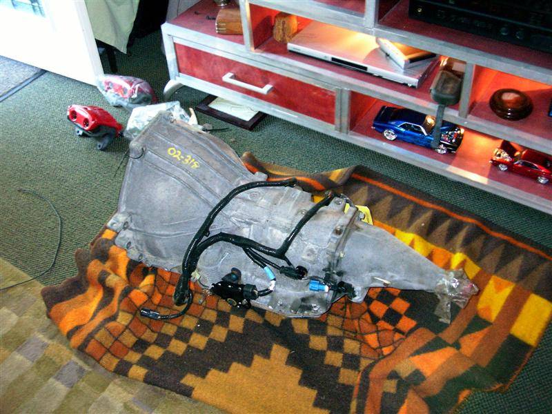

I'm putting a 99' 4r70w in and was wondering, will the better output shaft on the 99 make a big deference with my 4.10 gears and all the vibration or will I still need a new drive shaft?
The problem is in the length, and construction of the shaft it's self. A new output unit will do nothing to help this.
mike
Seems like it would depend on what is causing vibration in the first place, since either or both the output shaft/driveshaft can cause vibration. You won't know until it's in, really.
