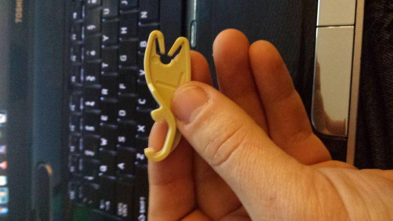

-separate the threaded rod (handle actuator) from the door latch (rotate the yellow retainer),

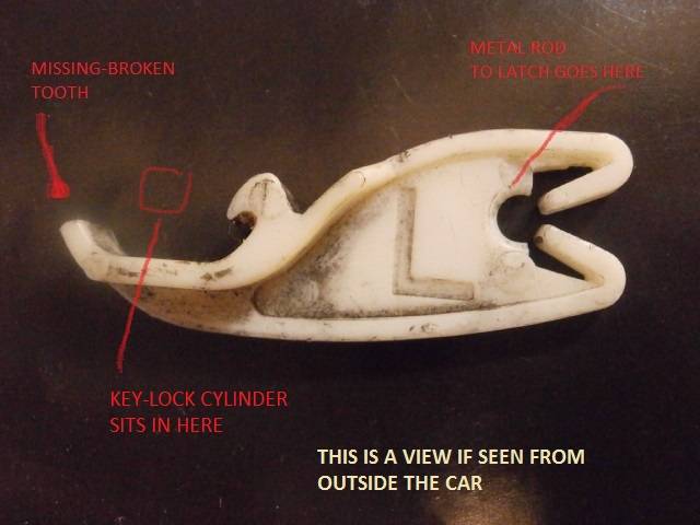

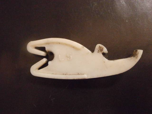

here's the key cylinder arm/lever
it's the lever that fits onto and connects the key lock cylinder to the thin metal rod down to the latch
1) is this a dealer-only part? I've yet to find it on Rock_Auto
2) what is the best method/sequence to put it all back together?
